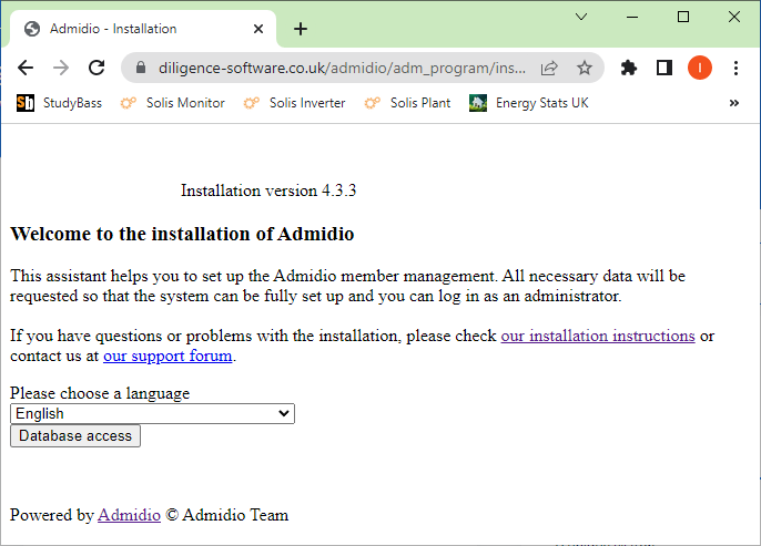

I follow the Instructions within Documentation, installation steps 1-4. However, I don't get the "pretty screen" shown in the instructions, but this:

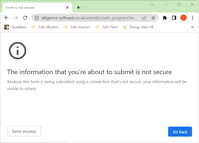

I want English, but I have also selected other languages with the same result. When I click "Database access" I get this:

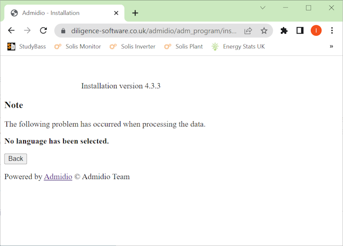

So I click "send anyway", and get this:

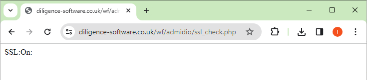

I forgot the attachement to my previous post. To understand your problem could you please upload the unzipped attached file and post the result.
If Admidio doesn't detect https automatically you can set $gForceHTTPS within the config.php

Yes, see result below, cheers Ian.
Re: Installation Failure
Thanks for this check. I think I found the problem. Our check for the value of the parameter is not case sensitive. In your case On is written with a capital O and we only check for lower case.
I will change that for the next version.
