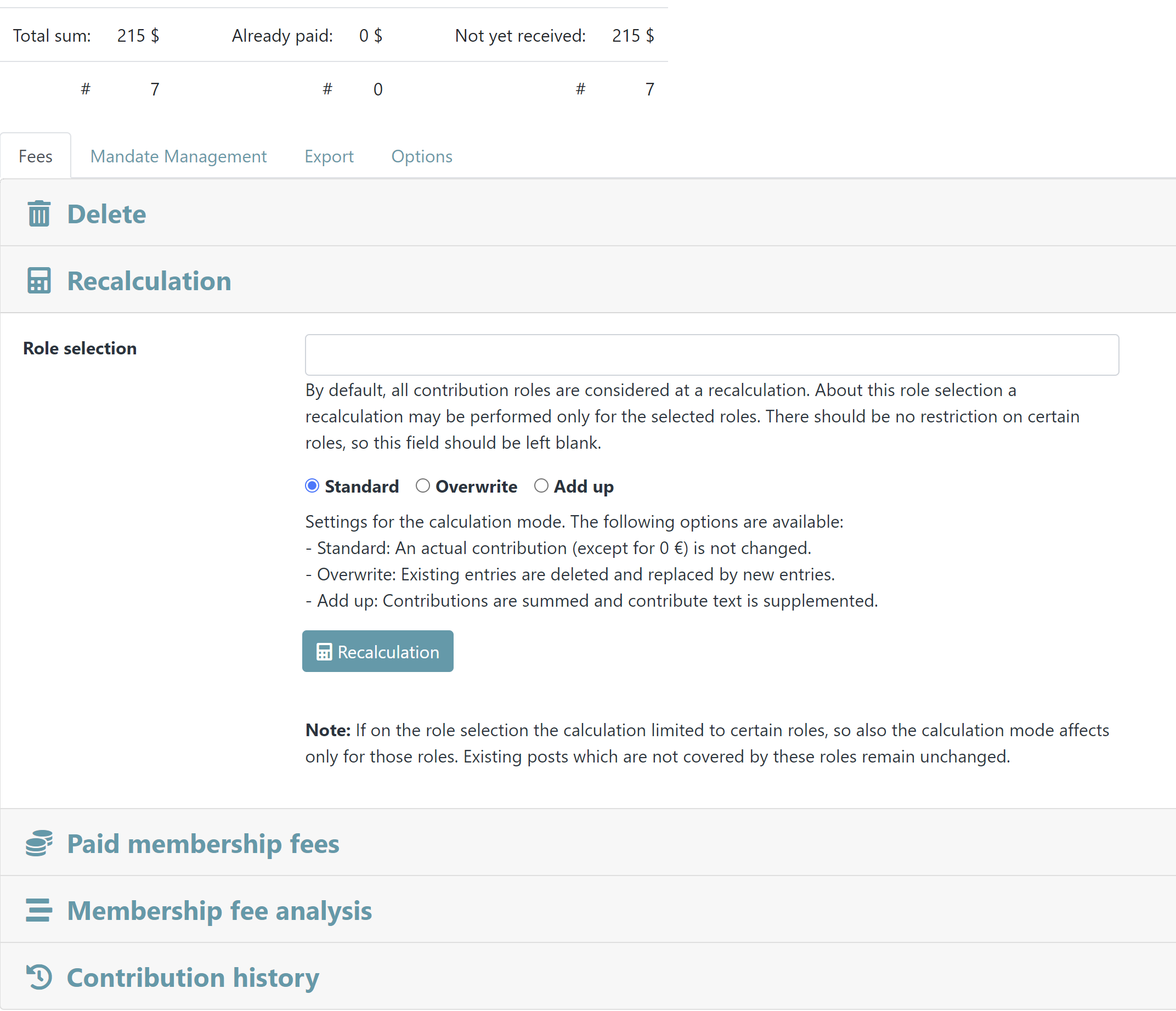

See the attached screenshot.
Where do I set the mandate information? Is this on the user? I must be missing something still on the setup. I just put 5.1.2 of the plugin with Admidio 4.1.5 and still the 500 error.
- I deleted everything first using the "Delete Heading" and all the options inside.
- I then executed the Recalculation
- Running the Paid membership fees next, results in a 500 error

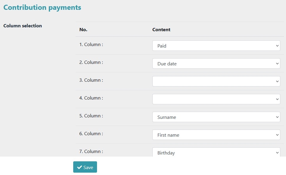

1. Activate debug mode (file adm_my_files/config.php: $gDebug=1; ) and run "Paid membership fees - Process membership payments" again. What error message is displayed?Running the Paid membership fees next, results in a 500 error
2. Please check whether there are empty fields under Content in Preferences-View Definitions. All fields must be filled here.

If you have started membership fee, there is a link to "MEMBERSHIP FEE" Preferences in the menu on the left (at the top). In the Preferences menu there is then "View definitions".
Please check whether there are empty fields under Content (in Preferences-View Definitions). All fields must be filled here.
Re: mitgliedsbeitrag - English Translation for Plugin Page?
There are columns missing in the view. What should these be set to?
With a new installation or after an update, it may happen that profile fields created by the plugin (e.g. "Due date") cannot be read. This then leads to these empty, unoccupied columns.
It is not necessary to specify a specific column here, it is sufficient if the save button is pressed (this will overwrite the incorrect configuration).

Finally figured this piece out, had a bunch of other columns I removed thinking they weren't needed. Thanks.

Go to "Preferences-View Definitions".
IBAN entry: The IBAN, BIC, account holder, etc. can only be entered via a member's profile.
- Under Mandate management, add the columns Mandate date and Mandate reference.
- Under Due date, add the column Due date.
- Don't forget to save.
