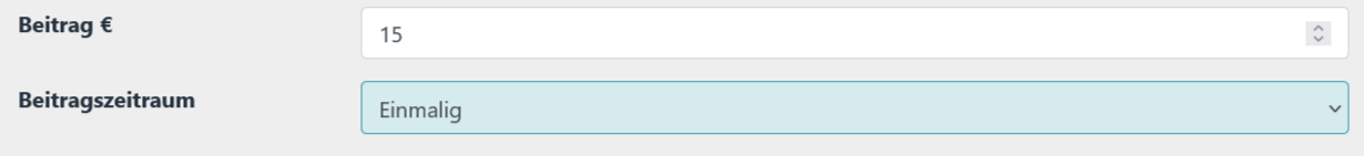

I tried this out on my own;
ONE amount is stored in the role;
amount in the role.png (14.26 KiB) 230357 mal betrachtet
the contribution calculation then looks like this:
the contribution calculation then looks like this.png (14.86 KiB) 230357 mal betrachtet
and appears for the member:
and appears for the member.png (13.98 KiB) 230357 mal betrachtet
now the member can/must pay; after payment, the calculation can be repeated

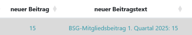

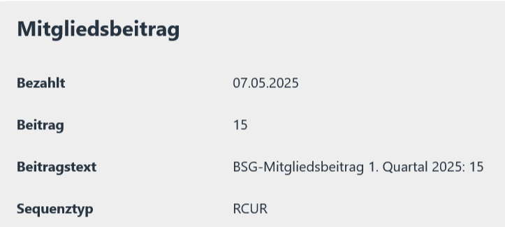

I tested yesterday
Eintrag nach Berechnung + Zahlung 1. Quartal.png (27.47 KiB) 200748 mal betrachtet
+ today
Eintrag nach Berechnung + Zahlung 2. Quartal.png (31.02 KiB) 200748 mal betrachtet
and it works !
Please note documentation/schedule ! Finalization of a contribution invoice
After ALL have paid
i modified the prefix in the contribution settings
then
Recalculation with overwriting carried out for the 2nd quarter
with a little testing it should also work for you
