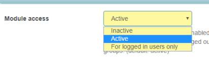

I read you post again - I now think I have the solution for exactly what you are asking for. You have to do two things :
- In the module settings for the announcements module, you set the module access to : Logged in users only.
- In the iframe you let the value be the value that Fasse gives for the announcements :
urlforyoursite+_program/modules/announcements/announcements.php
This way the following will happen :
If a user visits the link/iframe and is not logged in, then the user will only see the login.
If a user that IS logged in visits the link/iframe, then this user will see the announcement module.
Hope this was helpful

Re: How to Persist Login Context Through IFRAME?
Hi Schwartz, Fasse,
Thank you! The bit I was missing is the blogger URL pointing to the announcements.php page.
For some reason I thought i needed to point to index and unfortunately missed that in the earlier thread.
Thank you very much!
